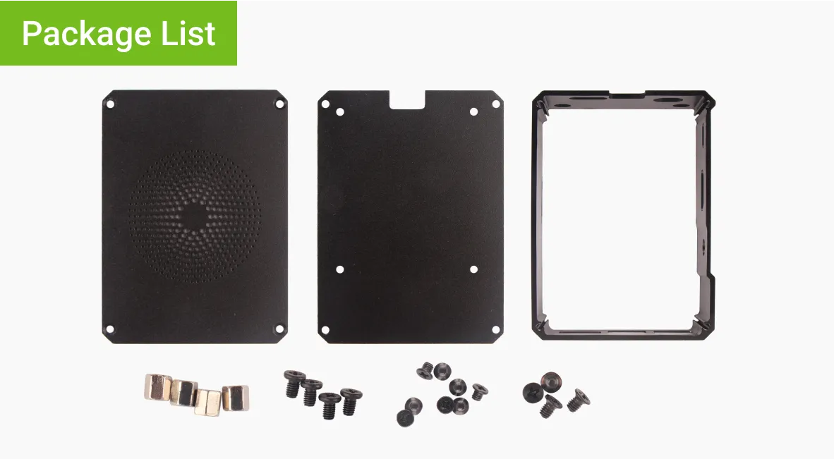

Package List

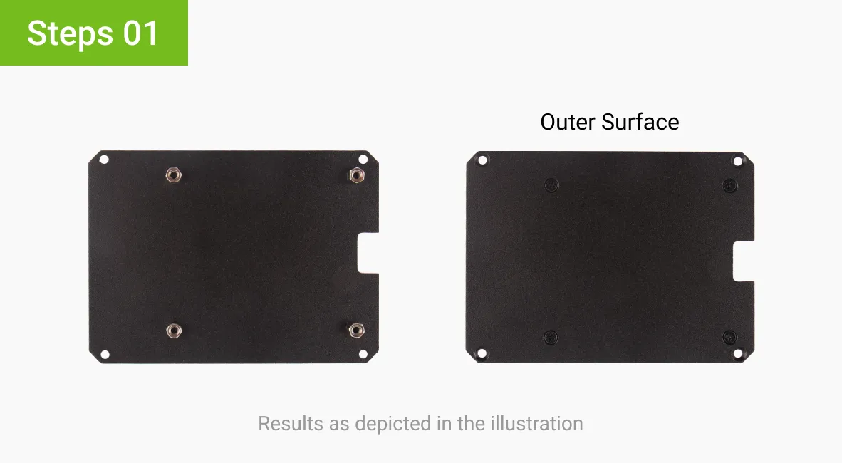

Please identify the outer surface of the top/bottom cover (the side facing outward), which features recessed or angled screw holes.
First, as shown, use four KM2.5x3mm screws to attach the four M2.5x5 copper pillars to the bottom cover.

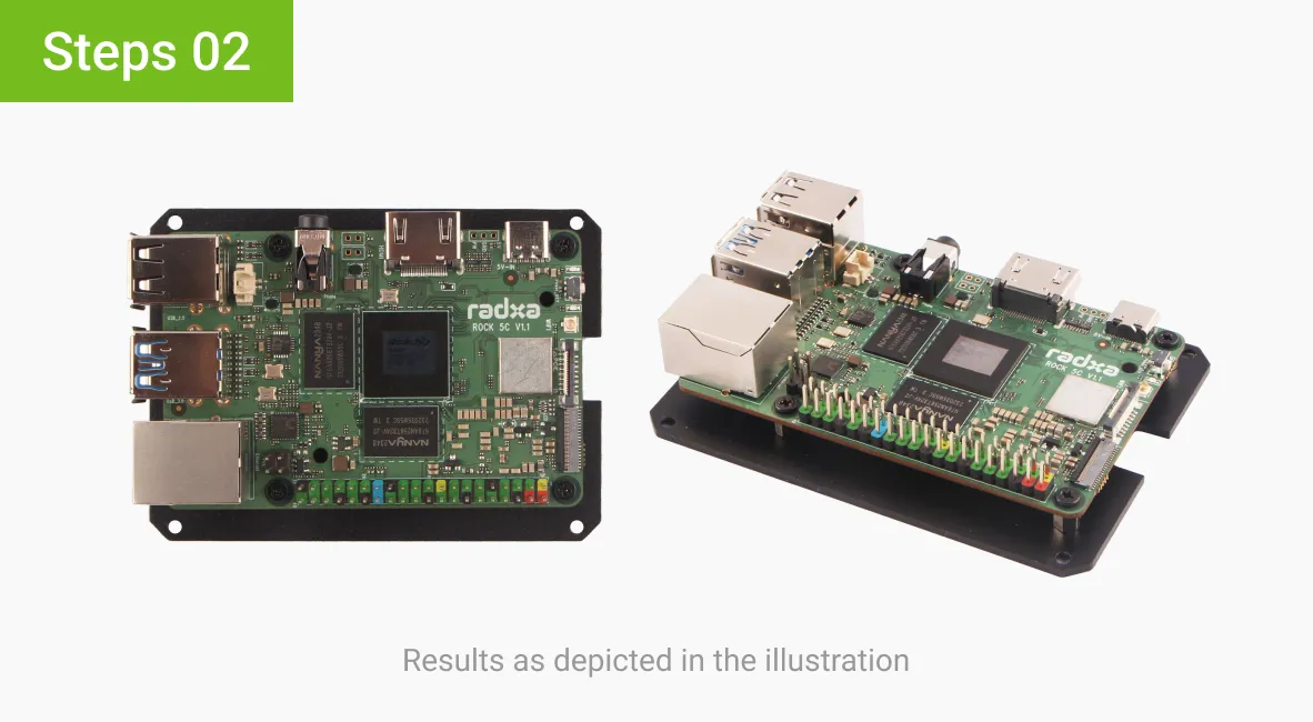

Next, as shown, secure the ROCK 5C with four CM2.5x4mm screws.

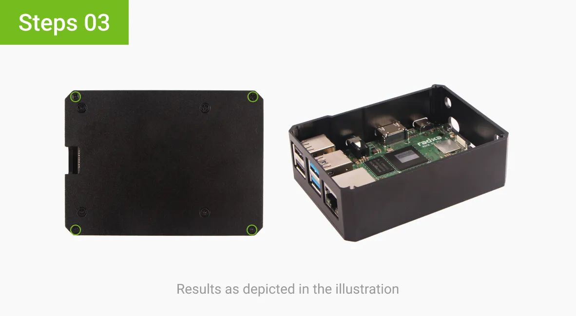

Then, align and install the middle frame as shown. Use four KM2.5x3mm screws from the bottom cover side to attach the middle frame, connecting it to the bottom cover.

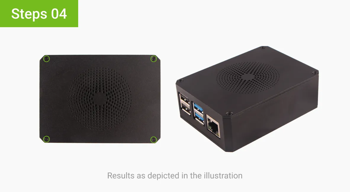

Finally, secure the top cover to the middle frame with four KM2.5x4mm screws with a CD pattern, completing the assembly.
